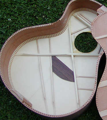

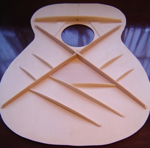

They say pictures are worth a thousand words, so here is a visual on what I am talking about:
In the first two pictures, notice that the tone bars are attached to the X-brace leg very close to the intersection of the "X" and are so long that they had to be tapered to nothing in order to miss the kerfed bracing when the top was attached:

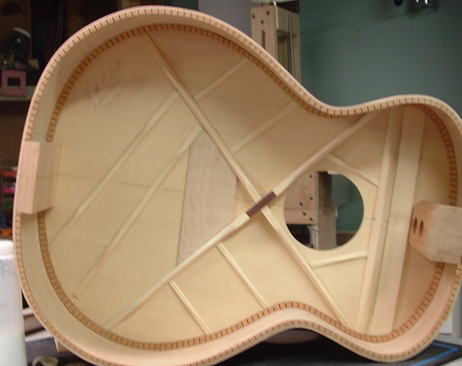

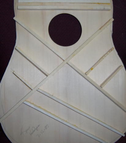

Now this next picture is one of my tops that is fresh out of the clamps and hasnt been cleaned up, shaped or sanded yet, but you can see that the tone bar is much further from the "X" intersection and will miss the bridge plate by a good way.
I realize that these are all different styles of guitars, but I am wondering what effect, if any, moving the tone bars closer to the bridge plate would have?
